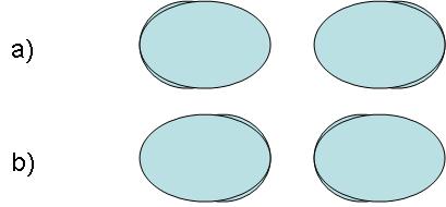

It has no brand, but I would like to know what are the positions of the tips of the admission ovoids and escape from the cam tree trees when the first piston is in the upper dead point

You have to put them at crossing, this means that both the escape and the admission should not be treading the valves, I mean pointing to the loura and not acting, both at the same height.

I mean the position of the ovoids goes the form a) ob) according to the aneity figure when the piston is above?
