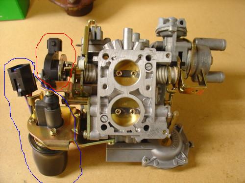

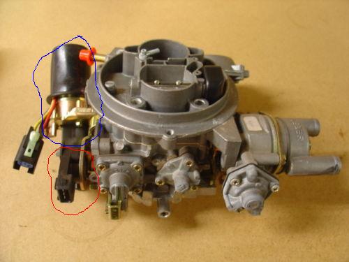

Well, this is the carburetor that rides my car ...
If I am not wrong, what is marked in Azul is the motor step by step but ... what is marked in red is the butterfly position sensor ??????
Thank you...

Your carburetor has a parsid like that of the Dart K these carry a hidden spre
