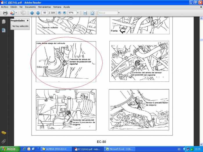

Hello, could someone help me to guide me about the location of the CKP sensor (Cigiga#Al) in a 2003 Nissan Almera, since it was already scanned and the fault code that throws, is the failure of said sensor, the car is going but does not turn on. I don't know the sensor visually, I don't know if it is hidden, or I haven't known how to identify it. I appreciate your attention.
12 years 9 months before #37388 by manual-mecanica
Manual-Mecanica Answer on the subject I need help with the location of the CKP Almera
The sensor is exactly under the starter engine you place it better if you see the vehicle below the vehicle.
