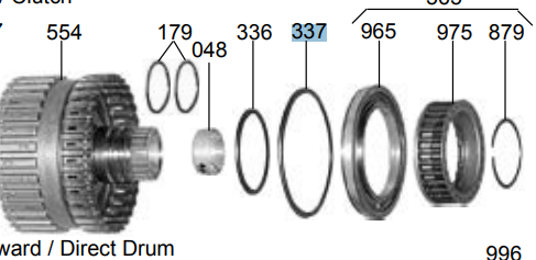

Hello king, did you put the same theme in Foromecanics?
After a lot of analysis for a couple of weeks, and before sending to disarm, apparently when those 2 codes, P0733 and P0734 are gathered in a CD4E box, if it is not a solenoid problem, everything leads to leagues/direct piston stamps damaged. If the second works well, then we would have to rule out problems with the fourth related to other clutches (the second and fourth work similar, with the drive of the second and fourth band by the Servo, but in the fourth the modulation by the PCM of the Torque converter valve is added, for which a certain oil pressure is needed), even more if after doing tests it is seen that the lock is seen. What I ask you is the following: the leagues you changed were broken or cracked but without cutting? Was the internal or external league, or both? In the image we see the direct 965 piston and the internal and external leagues 336 and 337.
